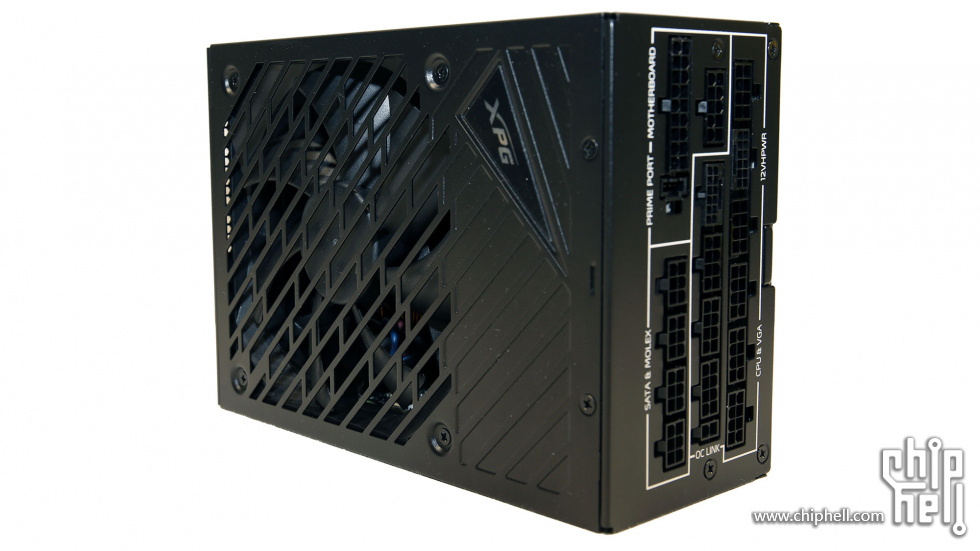

XPG Fusion 1600W Titanium PSU Review – Should Corsair Worry?https://hwbusters.com/psus/xpg-fusion-1600w-titanium-psu-review-should-corsair-worry/
Fusion1600作为台达首款消费级数字化电源备受期待,cybenetics认证的评测数据非常详细,具体可以在上面的链接。
然而,评测结果显示其性能并未达到预期,并与同为数字化方案的AX1600i存在明显的性能差距(甚至不如模拟方案海韵TX/PX-1600)。同时,Fusion1600的售价为700美元,与AX1600i相比价格差距也很明显。
不过,一个是ATX3.0标准,另一个则是非ATX3.0标准。不能直接将它们放在一起进行比较。根据Hwbusters的说法,AX1600i方案不太可能进行更新,更不可能推出ATX3.0版本。
评测总结:
XPG is trying hard to meet Corsair’s offerings in the PSU market. Given that Corsair has a long experience in this field, it will be challenging, but XPG has an outstanding team, and with EVGA out of the game, we need a second major player in this market. The Fusion 1600W is a good power supply, there is no doubt about that, but its price makes you want to scream. Its build quality justifies, to a degree at least, the high price and development cost for Delta, which has to be covered somehow. The major pain is that it cannot meet the AX1600i’s performance, and to make things even worse, it cannot even match the performance of the analog Seasonic TX/PX-1600. Currently, the price difference between the TX-1600 and the Fusion-1600 is 170 dollars, a notable amount given that Seasonic’s offering is not affordable. The digital circuits of XPG’s offering might not deliver higher performance, but the fact that you can adjust the fan speed profile and other PSU’s vital functions might appeal to some users. That said, the TX-1600 is dead silent, for its capacity, without requiring any adjustments from users, and this is highly desirable by most. You install it and forget about it, which is the best scenario for a PSU and, generally, for every PC component.
XPG正努力在电源市场上与Corsair竞争。考虑到Corsair在这个领域有着悠久的经验,这将是一个具有挑战性的任务,但XPG拥有一支优秀的团队,而且由于EVGA退出市场,我们需要在这个市场上有第二个主要竞争者。Fusion 1600W是一款不错的电源,毫无疑问,但它的价格让人想要尖叫。它的制造质量至少在一定程度上证明了高价格和Delta的开发成本,这些成本必须以某种方式得到补偿。主要的问题是它无法达到AX1600i的性能,更糟糕的是,它甚至无法与模拟的Seasonic TX/PX-1600相媲美。目前,TX-1600和Fusion-1600之间的价格差距为170美元,这是一笔可观的金额,考虑到Seasonic的产品并不便宜。XPG的数字电路可能不会提供更高的性能,但对于某些用户来说,可以调整风扇速度配置文件和其他关键功能可能具有吸引力。话虽如此,TX-1600对于其容量而言是完全无声的,不需要用户进行任何调整,这对大多数用户来说是非常理想的。您安装它,然后忘记它,这对于电源以及通常的每个PC组件来说都是最好的情况。
The XPG Fusion 1600 is a fine and expensive PSU, which can handle several RTX 4090s if you have the money to get them. If you don’t care about native 12+4 pin connectors and ATX v3.0 compatibility, which should be the case, you could pay less to get a Corsair AX1600i. Still, it is better to invest in something future-proof. 700 dollars for a PSU sound and are a lot, but from the moment an RTX 4090 costs more than double as much, and there are still people who buy these cards, there is a market for such expensive PSUs, which will outlast many GPU generations. I am tired of mentioning this, but I write it again, a good PSU is a good investment, given that you will use it for many years. This is why it needs to be as future-proof as possible.
XPG Fusion 1600是一款精良而昂贵的电源,如果您有足够的资金购买几个RTX 4090,它可以胜任。如果您不在意原生12+4引脚连接器和ATX v3.0兼容性(这应该是情况),您可以支付更少的费用购买Corsair AX1600i。不过,投资一些具有未来性的东西更值得。700美元对于一个电源来说听起来很多,但从RTX 4090的价格超过两倍,并且仍然有人购买这些显卡的那一刻起,这样昂贵的电源市场就有市场,而且它将比许多GPU代代相传。我已经厌倦了一再提到这一点,但我再次写下,一款好的电源是一个好的投资,因为您将使用它很多年。因此,它需要尽可能具有未来性。
优点:
强大的功率输出
在47°C下能够提供全功率输出
良好的性能表现
支持ATX v3.0和PCIe 5.0标准
较小的电压过功率保护(OPP)和过电流保护(OCP)设置
风扇故障保护
在12V和5V电压下负载调节稳定
良好的纹波抑制(但我预期会更好)
高品质的制造工艺
可以通过数字连接和提供的软件进行系统设置
可以通过软件设置风扇速度配置文件、过电流保护(OCP)、过温保护(OTP)、过压保护(OVP)和欠压保护(UVP)
高效的电源平台
高效的5VSB电压输出
较长的持续时间
支持替代低功耗模式(ALPM)
全模组设计
两个12+4引脚的PCIe连接器(每个可提供600W输出)
足够长的电缆
周边设备连接器之间有足够的间距(150mm)
长达十二年的保修期
缺点:
昂贵的价格
总体性能与AX1600i还有差距
瞬态响应应该更好,特别是在12V电压下
在230V电压下的待机功耗较高
开机冲击电流较大
超过100毫秒的开机时间(T1)
